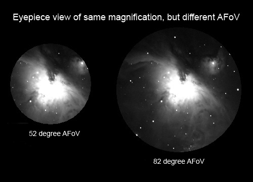

I create a simple example of the view through the eyepiece with same magnification, but different apparent field of view.
Same magnification, but different apparent field of view
Eyepiece AFoV View.jpg (71.06 KiB) Viewed 5323 times

thank alot... now i know what u mean haha
