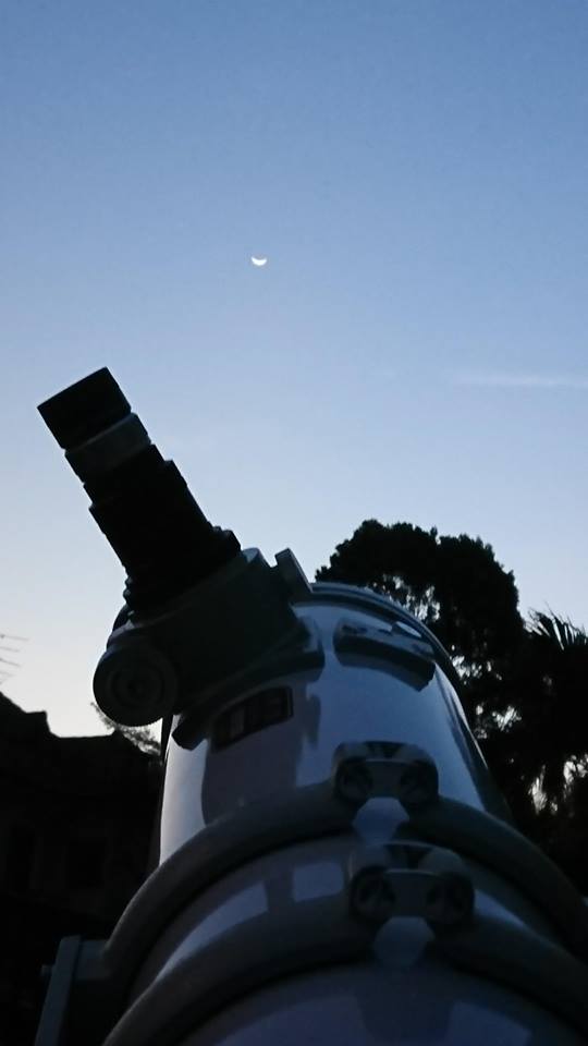

Thin crescent moon through 5mm EP with hp.
mt130 cresent ep.jpg (16.23 KiB) Viewed 23594 times
Dusk setup Dec 2017
Dusk setup Dec 2017
mt130 cresent.jpg (26.85 KiB) Viewed 23594 times

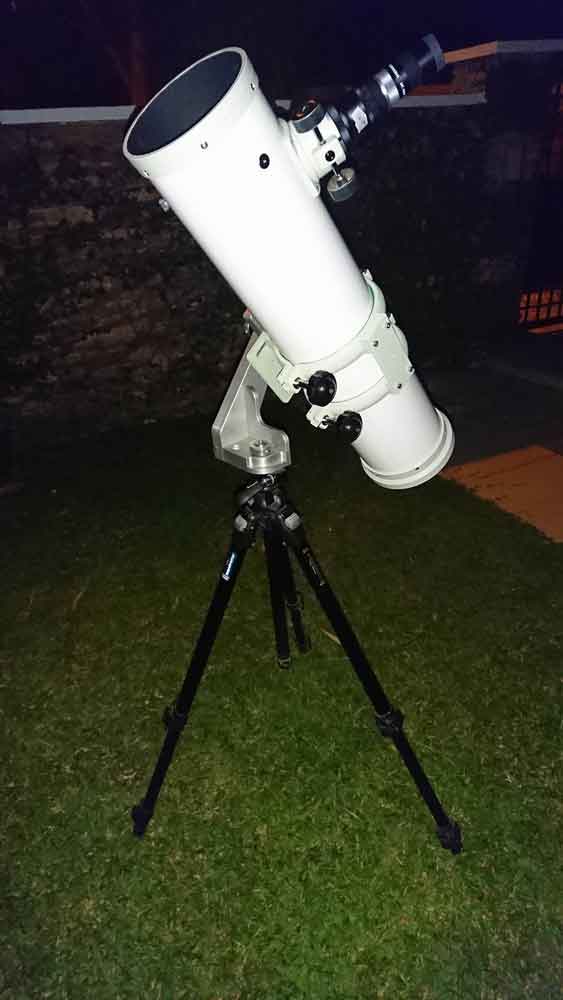

Mt130 setup on FTX mount

Hi
Great to see you have scope you love! Do post some photos of your setup :)
chancy_sg
Posts: 83
Favourite scope: Galileoscope
Re: A Newbie's Impression of the Takahashi MT130 Newtonian
Post by chancy_sg »
Pic as requested. :P
