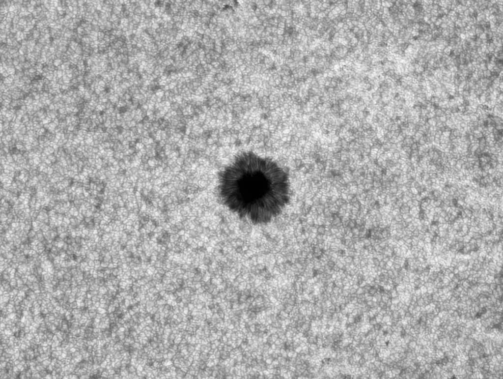

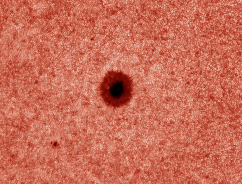

Finally I settled down to do some testing of a C8 Energy Rejection Filter (ERF) that I got recently. It is also a 3-band filter, permitting imaging in HA, CAK and 430nm (Fe-based) imaging of the Sun.
The setup was: ERF C8 SCT with Baader Herschel wedge + 1.25" H-A filter + x2.5 televue barlow + ASI174 mono camera.
The exposure was set to 0.291 msec to freeze the seeing condition. Here is the first light result:

Here is another image of that sunspot taken yesterday

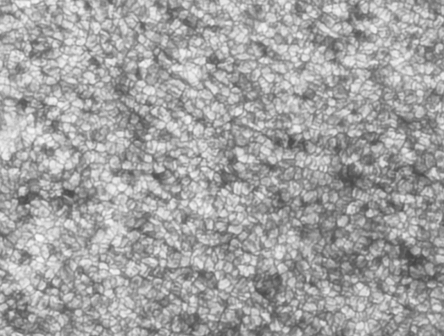

With the same ERF, I added a 25mm Edmund Optics 430/10nm filter and got this G-Band granulations.

The G-band images were obtained at the same time as the following 3-band images of the Sun in H-Alpha, CAK and whitelight bandwidths. It was a spotless Sun :)
