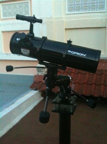

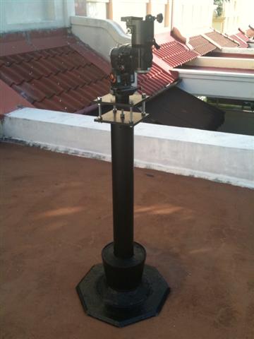

My set up of grab-and-go is more like lower-and-look. I am fortunate to have a car porch terrace which is located below my bedroom balcony. I have just finished setting up my home-made pier mount with a CG5 head [thanks Swimaniac] and a Orion 130mm ST [short tube] Newtonian on my terrace.
As I only paid US$99-00 for the Orion scope during their sale last July and which was brought back FOC through a friend, I am leaving the whole thing permanently outdoors and can risk fungus build up on the mirrors of the scope if my protection method does not work.
Based on my research, I cover scope and mount with a trash bag, then a Mylar sheet,then a canvas sheet. I stick a small bag of silica gel under the scope tube cover to absorb moisture and a box of dehumidifier under all those sheets of cover.
I believe it should work to keep the scope and mount dry.
To access the terrace, I need to lower myself with the aid of a rope from my balcony and start my observation. Hence, lower-and-look. :mryellow:
Actually I will also set up a black screen on the terrace for privacy and to block off the street lights. The screen is attached to aluminium poles which are inserted into tube holders permanently bolted to the terrace wall.
It takes about 5 minutes to start my obs.
Here are a couple of pics-
Full Mount (Small).jpg (20.61 KiB) Viewed 4141 times
Scope&Mount (Small).jpg (24.05 KiB) Viewed 4141 times

I like your pier and how you bolt the mount onto the pier.
If I have a roof terrace one day, please come and help me to make this pier

It works great cos I can level the mount by adjusting the plate bolts and I can easily adapt the top plate for different mount heads.

Yes, I can see the good thoughts that went into the design of this pier.
Good job there.

Post by timatworksg »
It makes his house look like something of a black-ops!! haha! Lower and look!!
Happen to past by and there he was up on the terrace roof fixing the CG5! Glad it worked out well 10,000rpm!! Would be interesting now to see how a scope will take the elements of SG! Hope to hear some feedback on this which could help in maintenance! All you need now are some chairs, a small table, beer and friends...haha! Just don't get drunk and fall off!!
Anyways, GREAT job on the pier!
