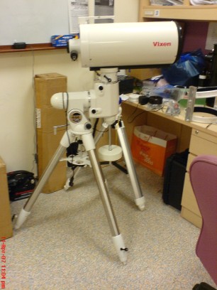

Hi all, I will give a partial review of this EQ6 Pro mount (also is Orion Atlas EQ-G mount).
Part 1:
Appearance:
It arrived in 2 boxes. One containg the mount head and controllers, the other one contains the 2" Steel tripod. Pictures later.
I also ordered the full pier for EQ6 with wheels!
The metal peg on the tripod is between 2 legs, hence half pier for EQ6 is not needed! Good news for all everybody seeking the ultimate 3 legs to hold your GP and variants mount head. Installation is very simple, the manual is not needed. But the mount head is very heavy! And another good news is, take out the front screw and the latitude adjustment can reach 0 degree.
The bad point is that the counterweight bar is slightly thinner than the vixen one and it retracts loosely not like the sphinx one. New vixen counterweights need to get longer screws to use the counterweight.
Ok, watch out for upcoming pics and part 2 reviews on GOTO electronics and part 3 on Autoguiding and imaging on this mount.
Thanks!
