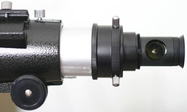

I was collimating my refractor using a cheshire eyepiece. The something strange... at least to me :P :P Below are two collimation result that I'm able to get, so which one is the correct one??
Thanks and have a nice day.
Collimation Result
Collimation Result
Collimation Setup
Collimation Setup
Is it the focuser?
The focuser position is same for both... What I mean is that I can collimate to either 1) The smaller brightest white "donut" in the center, but the two bigger "donut" (one grey colour and one green colour) is slightly offset or 2) The two bigger "donut" merge to one, but the smaller brightest white "donut" is off center. All this done without touching the focuser, just adjusting the lens cell comillation screws.
Currently, I adjust the collimation to 2 which I think is correct, but just wonder why the brightest smaller "donut" is not in the center... is it because the hole on the reflective surface in cheshire eyepiece is not round or not in the center??? Or should I adjust to collimation 2??
Hope those refractor expert can give some advice.
