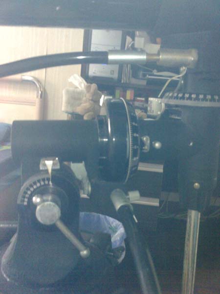

Hmm... move together?? Can you post an photo of the whole EQ mount and one photo on the metal pointer??
Need to identify which EQ mount are you using and what is the problem.

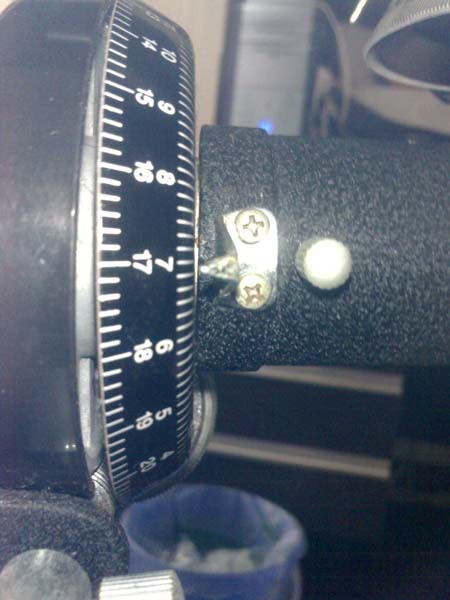

Here are the pictures! Hmm... Not a new telescope actually. Its a 2 year old thingy le. But since the circles are there, so I thought that I would try to learn how to use it lo :D
Equatorial mount
Equatorial mount
RA axis
RA axis

Ok... I think you are using the EQ2 Mount. There is a thumb screw beside the metal pointer, so tighten the thumb screw should keep your RA setting circle from moving. Try it.
By the way, I think you really need a manual and Celestron Manual are usually lousy... at least on the beginner scope. So go to the Orion support website ( http://www.telescope.com/shopping/brows ... anges=true ) and download the manual for SpaceProbe 130 EQ Reflector. They are the same scope and the manual should be able help on how to use your scope.
Enjoy and have a nice day.

Thanks for that manual! The information there contains far more than what the celestron manual have! But I still don't see some light over here... First, you locate a known star with known coordinates, so that you can set the RA circle and lock it. Since you locked the RA setting circle, that means the RA circle will follow the RA axis when you rotate the RA axis right... For example, if you located a star at RA 05hr 00min 00sec, then I'll lock the circle at value of 5 right. But when you use RA values to locate another star, won't the pointer still be pointing at "5" no matter how you rotate the RA axis?
Have you try tighten the thumb screw and rotate the RA axis?? After tighten the thumb screw, the matel pointer will move when you rotate the RA axis, but not the RA Setting Circle, right?? This will allow the metal pointer to indicate the new RA value as you rotate the RA axis.
